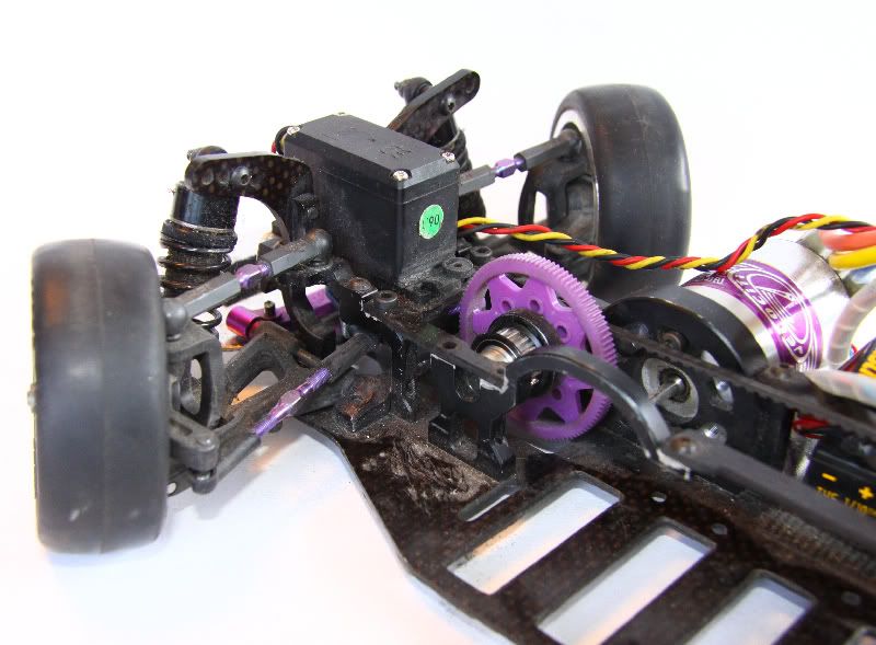

Step 1: Revert my forward-weighted, RWD drifter back into its original, stable touring-car platform. As the pictures show, my HB Cyclone is currently running in reverse with the long belt powering the rear (which used to be the front) and direct steering up front (where the rear diff used to be).

:laugh: A lot of broken hearts out there, I'm sure... Trust me, if I happened to have another chassis laying around, I'd keep this baby as it is for future cravings of masochistic pleasure.

So this is the new dragster? It's rwd right? And moving all the weight up front? Have you a chance to test it yet to see how it handles? It's the opposite weight balance I went for. about 30 up front and 70 percent in the rear

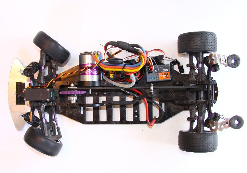

Here's some more pics to confuse Brayden. Chassis reverted back to stock layout (almost). Bansal was also kind enough to point out that a reversed one-way centre-pulley running to a front spool will give you 4-wheel braking while remaining RWD on throttle. It was right in front of my nose from the R/T line-lock but I just hadn't seen it. Thanks Jeevs!
Cut some touring rims and slapped on some o-rings (yet to be tested).
alan
Update: The reason I was able to pull out and reverse the internals of the one-way was because it's slipping so all the front drive components have been yanked. The front is now even lighter and controlled braking with the rear only is no problem at all.
